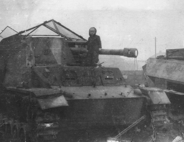

probably the only known photograph of the Hummel-Wespe self-propelled gun; source: Flickr.com, published with the permission of the original contributor, edited

The only known photograph of the Hummel-Wespe is said to have been taken around the turn of 1945/46, apparently in the village of Košťany near Teplice. The wreck in the image has a frame mounted above the open fighting compartment, presumably intended to support wire mesh as protection against grenades being thrown in.
