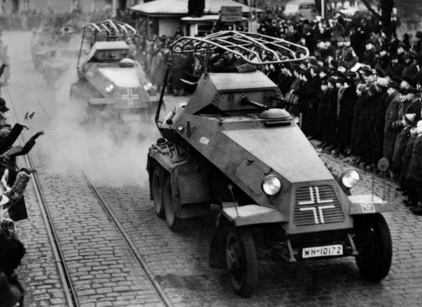

Sd.Kfz. 232 on the Büssing-NAG chassis, source: warwheels.net with the permission of the site operator, edited

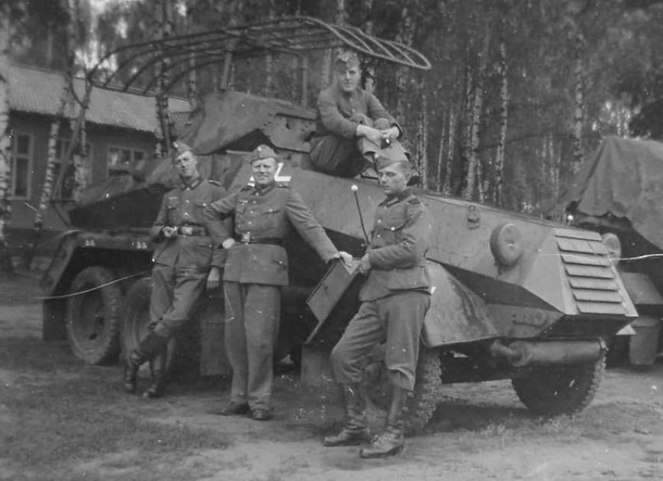

Even while the six-wheeled armoured car Sd.Kfz. 231 was still being developed, the designers were working in parallel on a radio-equipped version. As early as 1932, a first prototype of such a radio car was built on the Büssing-NAG G31 chassis. The vehicle still had a pre-production hull and a circular-plan turret with walls perpendicular to the ground. At this stage it carried only a single MG 13 machine gun in 7.92 mm. Above the hull, a frame antenna was mounted on six struts — at this point still in a very simple form without any internal bracing. Development continued alongside that of the Sd.Kfz. 231 itself until both vehicles reached their final production form.

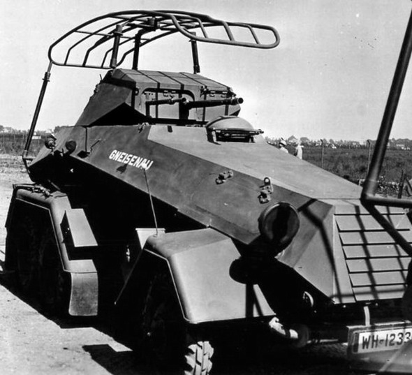

an interesting variant of the Sd.Kfz. 232 — a prototype hull fitted with the production-series turret, source: Flickr.com with the permission of the publishing user, edited

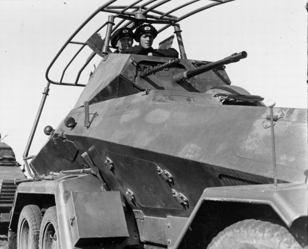

Sd.Kfz. 232 on the Daimler-Benz chassis, with the later-pattern gun mantlet with the machine gun on the left, source: Flickr.com with the permission of the publishing user, edited

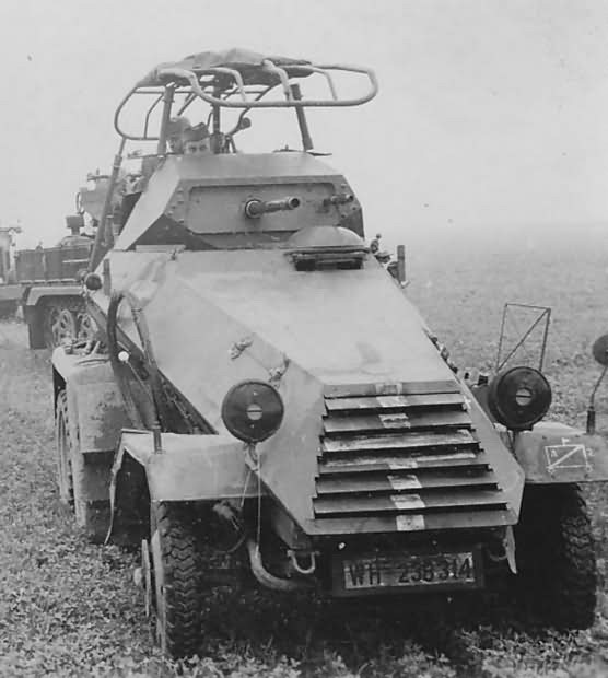

The hull, turret and armament were all taken directly from the standard armoured car Sd.Kfz. 231. Were it not for the large frame antenna, the Sd.Kfz. 232 and the 231 were externally identical. The armoured hull consisted of upper and lower halves with walls angled in opposite directions, so the vehicle widened from the floor upwards, then the side walls kinked and narrowed again towards the roof. This angling meant there was no flat surface on the sides that an enemy projectile could strike at a right angle — it would always hit obliquely. This increased the walls' resistance to penetration and compensated, at least in part, for the necessarily limited absolute armour thickness.
The armour plate from which the hull was welded was 14.5 mm thick at the front and 8 mm on the side walls. The roof and floor were 5 mm thick. The hull extended significantly forward to accommodate the engine compartment. The crew compartment occupied the rear half of the hull, topped by a fully rotating fighting turret.
The engine compartment glacis was sloped, and virtually its entire surface was taken up by the air intake opening for the powerplant, covered by horizontal steel grilles. The headlights were mounted on the sides of the engine bonnet, behind which were service access hatches. The crew had several hatches available for entry and exit. In the lower section of both side walls, in the space behind the front wheel mudguards, were diamond-shaped hatches closed by two-part covers.

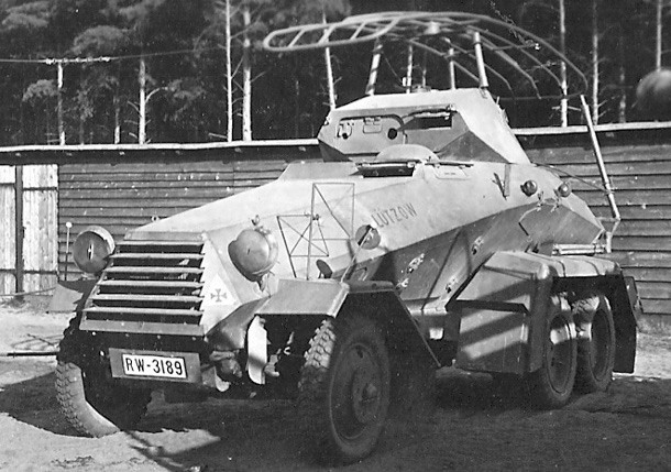

Sd.Kfz. 232 on the Magirus chassis, note the long front mudguards, source: warwheels.net with the permission of the site operator, edited
A further large hatch was located in the rear hull wall, with two-piece doors that opened outwards to the sides. On most vehicles a spare wheel was mounted across the rear hull wall, so the bracket had to be swung downwards before the hatch could be opened. For this reason the rear hatch served primarily as an emergency exit. A final hatch was located in the cabin roof forward of the turret on the right-hand side (to the right of the cupola above the driver's head) and was used mainly by the driver.

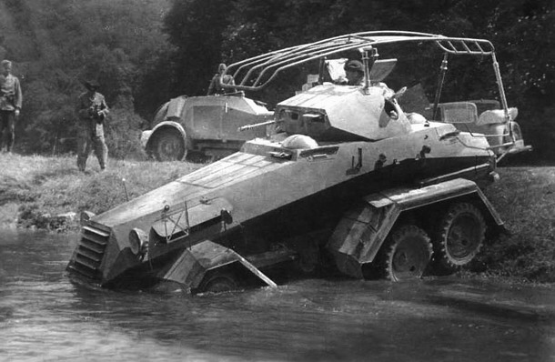

But back to the vehicle's construction. On each side of the hull, in its widest section, were two headlights — one facing forward and one rearward. An interesting feature was a further folding headlight located in both side walls above the rear wheel mudguards. Under normal circumstances this light was folded flush into the armour and its cover was barely noticeable. Its purpose was to provide additional illumination for night-time aiming — which is probably why I have never come across a single photograph showing it in the deployed position.

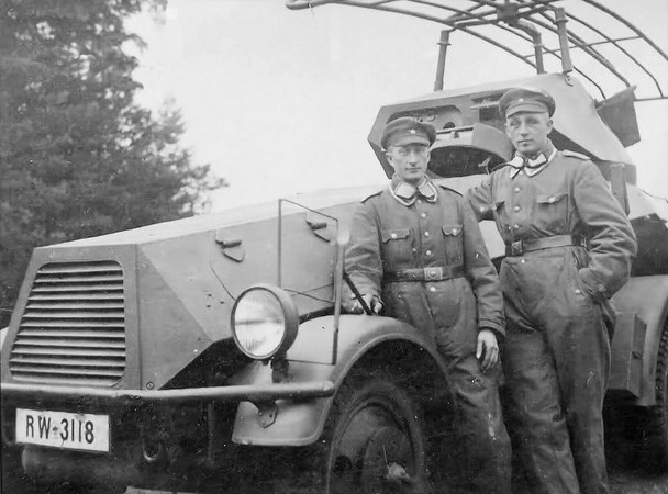

a closer view of the Sd.Kfz. 232; note the painted false vision ports on the front and side walls of the cabin, and the rotating joint on the antenna strut above the soldiers' heads, which allowed the turret to traverse, source: Bundesarchiv_Bild_102-04757A, Wikimedia, Creative commons, edited
While fitting radio equipment into a standard armoured car fulfilled the requirement, it also brought certain problems: the installation of the radio sets considerably reduced the interior space available to the crew and caused them significant discomfort when carrying out combat tasks. The desire for a more satisfactory solution eventually led to the development of another radio car based on the same platform — the vehicle that received the designation Sd.Kfz. 263.
