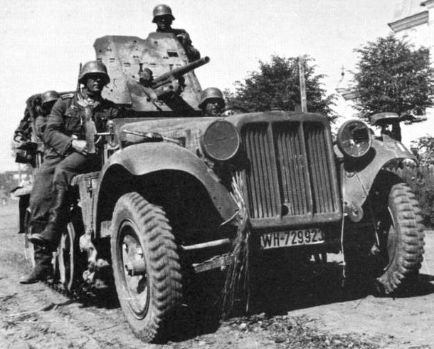

Mounting of the Flak 30 gun was also tested on the pre-production D6 half-track, source: worldwarphotos.info, used with permission of the site operator, edited

As photographs confirm, the D6 half-tracks were used to trial most of the later specialised sub-variants of the Sd.Kfz. 10, including the decontamination vehicle (later introduced as the leichte Entgiftungskraftwagen (Sd.Kfz. 10/2)), the contamination-laying vehicle (later introduced as the leichte Sprühkraftwagen (Sd.Kfz. 10/3)), and the mounting of the Flak 30 anti-aircraft gun (which would become the Sd.Kfz. 10/4).

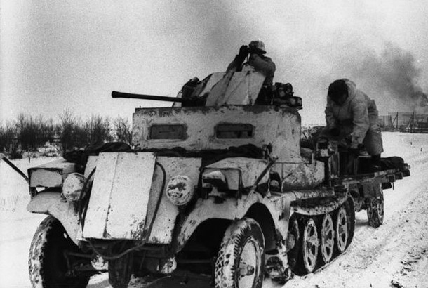

Sd.Kfz. 10 in winter camouflage, source: Bundesarchiv_Bild_101I-268-0180-03, Wikimedia, Creative commons, edited
In its basic configuration, the Sd.Kfz. 10 served as a cargo tractor for towing light artillery pieces and transporting their crews. For this purpose, the rear utility space was fitted with seating for up to six soldiers. The vehicle's own weight without load was 3.4 tonnes. According to specification, the Sd.Kfz. 10 could carry a payload of up to 1,500 kg while simultaneously towing a trailer of up to one tonne. The half-track was primarily used to tow the 37 mm PaK 36 anti-tank gun, the 20 mm Flak 30 anti-aircraft gun, or the 75 mm leIG 18 light infantry gun. From around mid-1940 a stronger towing coupling was introduced, enabling the vehicle to haul heavier weapons such as the 150 mm sIG 33 heavy infantry gun or the 50 mm PaK 38 and 75 mm PaK 40 anti-tank guns.

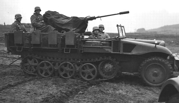

Sd.Kfz. 10/4
For enthusiasts of military hardware, the most interesting sub-variants are the Sd.Kfz. 10/4 and Sd.Kfz. 10/5. Both involved the installation of an anti-aircraft gun, transforming a simple cargo tractor into a self-propelled weapon. The Sd.Kfz. 10/4 was armed with the 20 mm Flak 30 gun. Production began as early as 1939, with 195 units built for the army (Heer) and a further 175 for the Luftwaffe. The first experiments with fitting this weapon to the light half-track had, however, taken place earlier — initially on the prototype D3 and later on the pre-production D6.

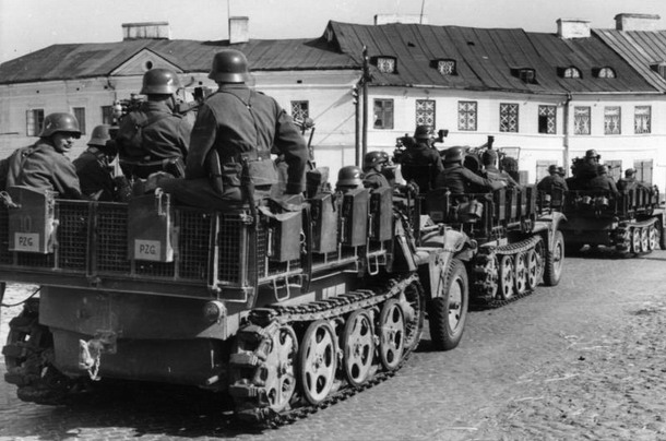

Rear view of Sd.Kfz. 10/4, source: Bundesarchiv_Bild_101I-380-0086-27, Wikimedia, Creative commons, edited
On the Sd.Kfz. 10/4, the rear utility space was converted into a single wide platform fitted with several clamps to secure the gun's mounting base. It was separated from the driver and commander's cab at the front by a simple tubular frame. Along the sides and rear, the fighting platform was enclosed by a low fence of steel mesh. The sections of this fence could be folded outward to the sides or rearward so as not to obstruct the gun's traverse. When folded flat, they lay horizontally, flush with the platform floor, and could bear a considerable amount of weight — effectively acting as an extension of the fighting space, giving the gun crew more room to work. Crews sometimes made use of the folded-down sides for travelling as well.
On the outside of the fence hung boxes for ammunition magazines — two at the rear and four on each side. Each box held one magazine of twenty rounds, giving a ready supply of 200 rounds in total. Additional ammunition was carried in a towed trailer (Sonderanhänger 51), which reportedly held 640 rounds and also carried a portable coincidence rangefinder for more precise fire control.
The gun was installed together with its mounting base, which kept it fully traversable through 360 degrees. In elevation it could be moved from -10 to +90 degrees. The weapon was fitted either with or without its original gun shield. When retained, the shield offered the open-platform crew at least some sense of protection, though it was rather large and uncomfortably increased the vehicle's profile, making it easier to spot. It also likely complicated the gun crew's work by taking up the already limited fighting space.

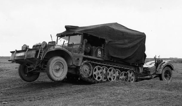

Sd.Kfz. 10/4 with canvas cover erected and Sonderanhänger 51 trailer, source: Bundesarchiv_Bild_101I-163-0323-13A, Wikimedia, Creative commons, edited
The Flak 30 was a widely used and reliable weapon — and crucially, it was small and light (weighing around 450 kg), meaning it presented no difficulty to the chassis of Germany's smallest half-track. Its effective ceiling of 2,200 metres was nothing spectacular, but it was more than adequate for the task at hand: defending moving columns of military vehicles from low-level enemy air attacks. The gun's main weakness was its low rate of fire. While the theoretical rate was around 280 rounds per minute, in practice it was closer to half that.
During 1940, two notable improvements were introduced into Sd.Kfz. 10/4 production. The first was the fitting of rifle racks on the front wheel mudguards on both sides of the vehicle — each side holding three standard K98 rifles. The second was the addition of a loading ramp, made up of two rails each consisting of two sections. When not in use, the folded sections were stowed in a rack on the vehicle's nose. Together with the Sonderanhänger 51 trailer, this ramp allowed the crew to carry out a complete removal or replacement of the gun in the field without any need for a workshop visit.
The procedure involved removing the wooden crate from the trailer, loading the gun together with its mounting base onto the empty trailer frame, and then pulling the trailer up the ramp onto the fighting platform, where the gun was unloaded and secured to the floor. Despite the gun weighing roughly half a tonne, a crew of six could manage this operation in the field. The hardest and most dangerous part was pushing the loaded trailer up the ramp onto the platform. To ease this, two pulleys were mounted on either side of the tubular frame separating the platform from the driver and commander's cab, allowing one man on each side to haul the gun upward with a rope while others pushed from behind.

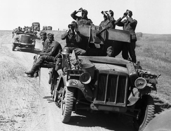

Sd.Kfz. 10/4 in action — note the loaders passing ammunition from the trailer, source: Flickr.com, used with permission of the publishing user, edited
This degree of self-sufficiency was highly practical. A proportion of Sd.Kfz. 10/4 vehicles were in fact delivered without a gun and served as support and ammunition carriers accompanying the armed vehicles. If an armed half-track suffered engine or running-gear damage, the crew could quickly transfer its gun to an unarmed carrier vehicle, preventing any reduction in the unit's firepower. Such unarmed carriers were not uncommon — according to regulations, an anti-aircraft platoon (Kompanie) was equipped with 18 Sd.Kfz. 10/4 vehicles, of which 12 were armed and 6 were not (a full third of the total).
