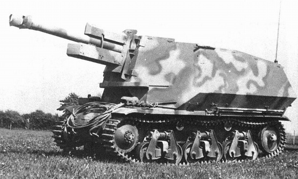

The leFH 18 self-propelled gun on the chassis of the captured French Hotchkiss tank, source: Flickr.com, with permission of the publishing user, edited

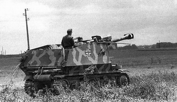

The 10.5 cm leFH 18 on the Hotchkiss tank chassis — the large unbroken expanse of the fighting compartment's armour made a conspicuous target, so it was worth breaking it up with a suitable camouflage pattern, source: Flickr.com, with permission of the publishing user, edited

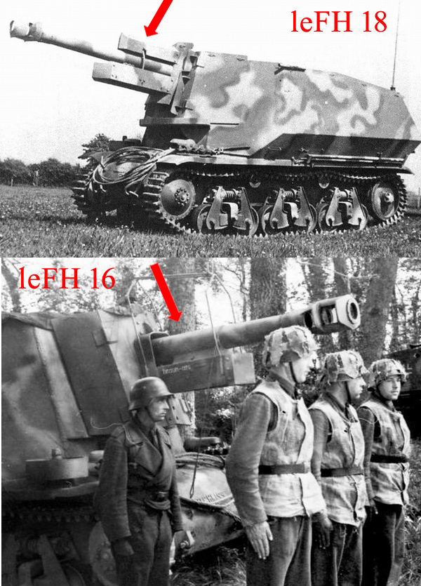

The front wall of the fighting compartment had an opening through which the howitzer barrel passed. On the outside this opening was covered by a wide gun shield that traversed laterally together with the barrel. We have said the vehicle was armed with a 105 mm howitzer — but we have not said which type, because there were in fact two. The majority of vehicles (judging at least by the relative frequency of photographs) received the leFH 18 howitzer (leFH = leichte Feldhaubitze), while some carried the considerably older leFH 16. Distinguishing between them is straightforward: the older leFH 16 had a single-piece recoil mechanism with its cylinder located below the barrel only, whereas the newer and more capable leFH 18 had recoil cylinders both below and above the barrel (comparative photo HERE). Both weapons used the same shells, the most common high-explosive fragmentation round weighing 14.81 kg. The older leFH could send this shell to a maximum range of 9,225 metres; the leFH 18's maximum range was nearly 1.5 kilometres greater. It is nonetheless probable that when the gun was installed on the relatively light Hotchkiss chassis, the use of the heaviest propellant charge was prohibited, meaning the self-propelled gun's effective range was in practice somewhat less than the figures quoted above.

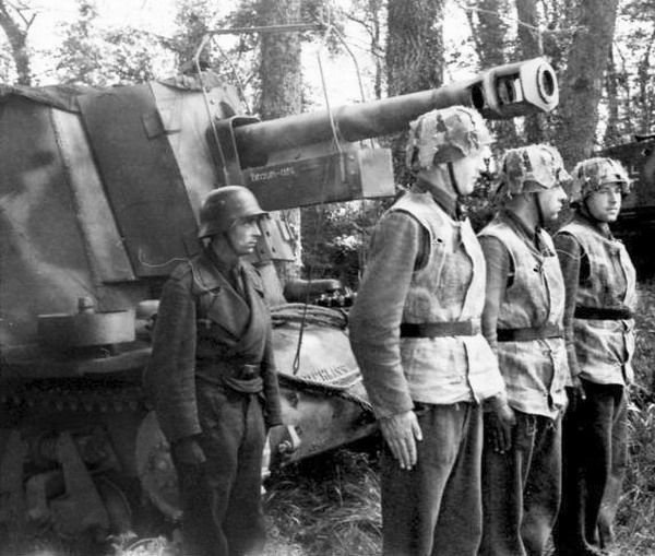

This vehicle carries the older leFH 16 howitzer version — note that the recoil mechanism is located below the barrel only. This photograph was also taken during Rommel's inspection of the 21st Panzer Division, source: Bundesarchiv Bild 101I-300-1865-06, Wikimedia, Creative Commons, edited

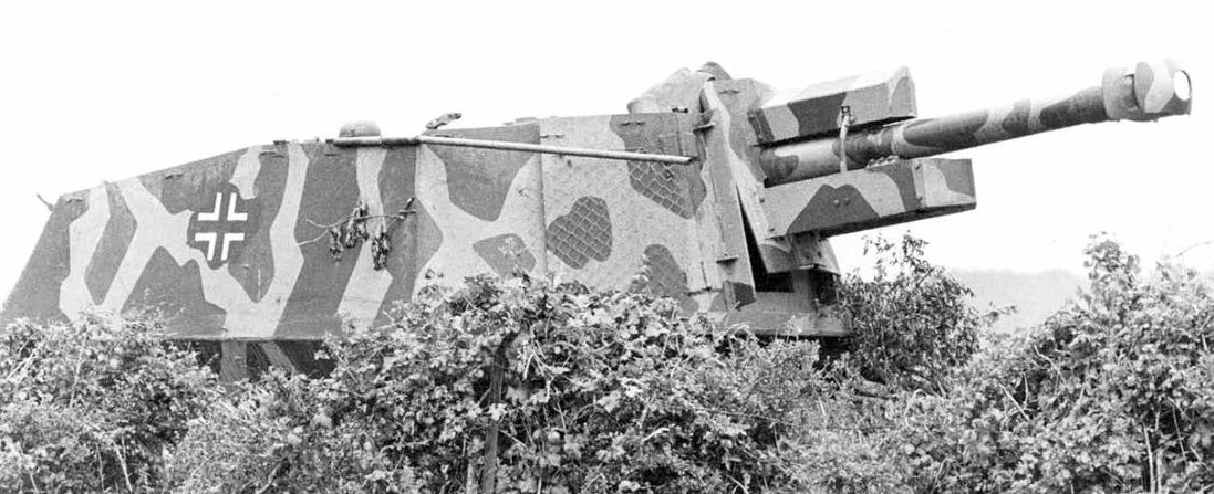

A 10.5 cm leFH 18 on the Hotchkiss tank chassis "hidden" in tall vegetation, source: Flickr.com, with permission of the publishing user, edited
