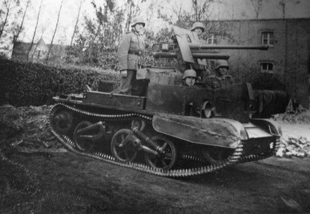

Unfortunately, little detail is available about the conversion of the carrier into a mount for the 47 mm anti-tank gun. The precise period in which these conversions were made is unknown, as is the number of vehicles built. Some authors attribute the conversions to the well-known Baukommando Becker, though this is most likely incorrect. To be frank, the conversion of the carrier into a tank destroyer was so elementary that any small workshop could have managed it – no complex factory-level machinery was needed. It was essentially an assembly of existing components. The two principal elements were of course the Universal Carrier and the Böhler Model 1935 47 mm gun. A third conspicuous element was the gun shield, which can be seen in photographs in at least three different configurations – but more on that shortly.

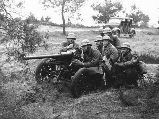

Let us look a little more closely at the vehicle's main armament: the Böhler Model 1935 gun. Although of Austrian manufacture, the Germans acquired it as booty from the defeated Dutch Army. The Netherlands had purchased somewhere between 370 and 380 examples of this anti-tank gun between 1937 and 1940. How many fell into Wehrmacht hands after the Dutch capitulation is unknown, but the number was certainly not negligible. The Böhler Model 1935 was a solidly effective weapon for its time. Its 1.44 kg anti-tank round left the barrel at approximately 630 m/s (660 m/s is also quoted) and at 500 metres could penetrate armour up to 43 mm thick (though some authors give only 35 mm) – more than enough for all German tank types of the period, with the exception of the latest variant of the Panzer IV, the Ausf. D, whose hull had 60 mm of frontal armour. A trained crew could fire up to 15 aimed rounds per minute. In German service the weapon received the designation Pak 188 (h).

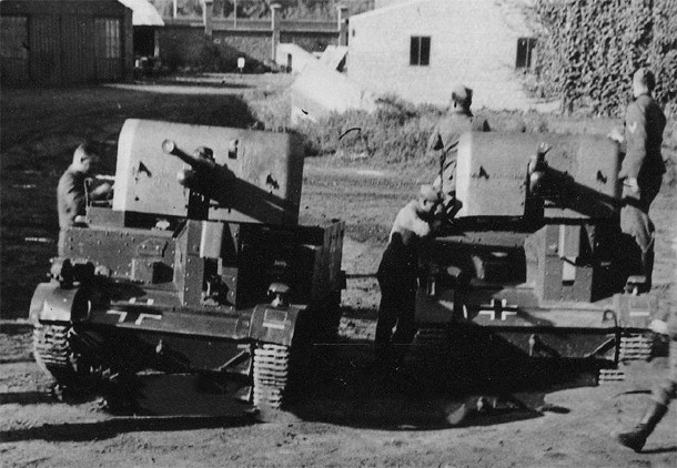

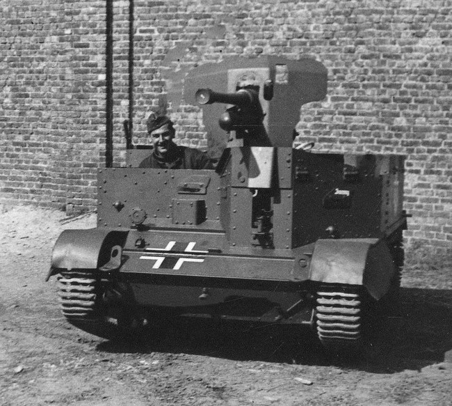

The original Austrian weapon apparently came with a shield angled at 45 degrees, which the Dutch soldiers found unsatisfactory and therefore did not use. Indeed, in all available photographs the gun is seen without any shield (e.g. HERE). For the self-propelled version, however, the Germans did want some form of shield and apparently tried several – at least, photographs show shields in at least three distinct configurations. One series of images shows a single vehicle fitted with only a small flat gun shield, and with the side and rear armour of the fighting compartment removed. It is quite possible that this was only an initial test prototype, a suggestion supported by the fact that the vehicle still retains its original British headlights rather than the German Notek blackout light (photos HERE and HERE).

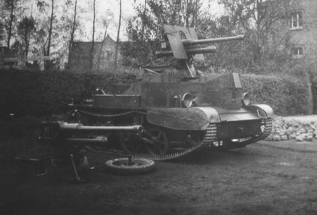

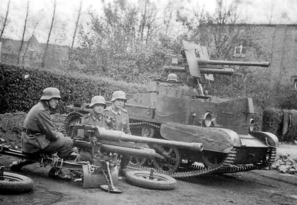

4.7 cm Pak 188 (h) auf Selbstfahrlafette Bren (e). Source: Flickr.com, with the permission of the publishing user, edited.

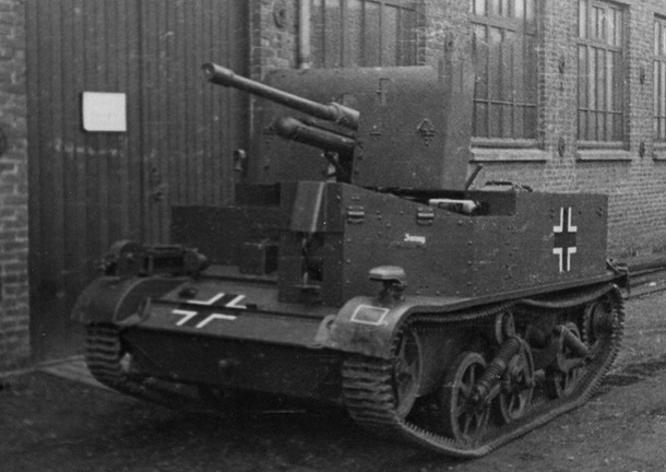

The standard configuration used a considerably larger shield taken from the captured British QF 2-pounder gun. This shield first had to be trimmed slightly at the bottom to fit the new weapon, and the barrel cutout extended further upward. The third of the three documented shield variants had large cutouts at the bottom on both sides, leaving very little of the original shield material in place (photo HERE). In this last case, it may simply have been an improvisation made by a particular crew.
