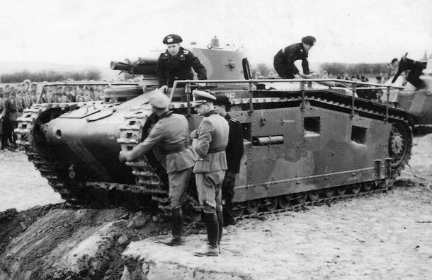

Krupp Grosstraktor during trials, source: Flickr.com with permission of the publishing user, edited

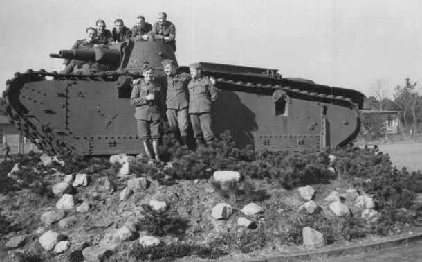

Rheinmetall-Borsig Grosstraktor preserved as a monument, source: Flickr.com with permission of the publishing user, edited
Each firm was to design and manufacture the components for its own vehicle, with Rheinmetall carrying out the final assembly of all prototypes. In addition, Daimler and Rheinmetall were to reach an agreement regarding the turrets: under this arrangement Rheinmetall was to develop and build the turrets not only for its own prototype but also for the Daimler-Benz vehicle. Some historians argue that the Army specification included a requirement for broad interchangeability of major components between the manufacturers' designs – a theory that the close similarity of the three finished vehicles would certainly support.
All three designs showed the clear influence of First World War construction standards and of British and French heavy tanks. The track assembly was very tall, with the upper run of the track reaching as high as the hull roof. At the front of the hull was the driving position, followed by the crew compartment with the main fighting turret above it. Behind the crew compartment was the engine section, and at the very rear a secondary machine-gun turret.

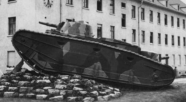

Daimler-Benz Grosstraktor preserved as a monument, source: Flickr.com with permission of the publishing user, edited
The running gear of Grosstraktor I consisted of sixteen small road wheels on each side. The first two wheels were positioned above ground level and served to support the track when mounting an obstacle. The road wheels were paired into eight two-wheel bogies. The rearmost six bogies were then grouped in pairs and suspended from a shared mount using a single large horizontal leaf spring. Almost the entire track assembly was covered by external side armour featuring semicircular service openings – it is in fact these distinctive openings that make the Daimler-Benz vehicle easy to identify in photographs.
The front of the hull was formed by sharply angled upper and lower plates meeting at a rounded nose. A machine-gun embrasure was located in the right side of this nose. Towing hooks were attached to the lower front plate.
A large headlight housed in a closable metal casing was set into the centre of the upper front plate. This plate transitioned into the roof of the crew compartment. In the forward part of the compartment sat the driver on the left and the hull machine gunner on the right, positioned side by side. Each was provided with his own cupola overhead, circular in plan and fitted with vision ports around its circumference. The top of each cupola was almost certainly fitted with an access hatch.
Krupp Grosstraktor preserved as a monument, source: Flickr.com with permission of the publishing user, edited
Behind the driver's and machine gunner's positions came the crew compartment for the remaining three soldiers and the main fighting turret. The turret walls tapered conically, which increased their resistance to enemy fire. A 75 mm gun and a coaxial machine gun were mounted in a movable mantlet in the front wall. The side walls of the turret featured small closable circular openings, most likely pistol ports for the crew's personal weapons. The commander, gunner, and loader were stationed in the turret, entering and exiting via a hatch in the turret's rear wall – and possibly also through one in the roof.

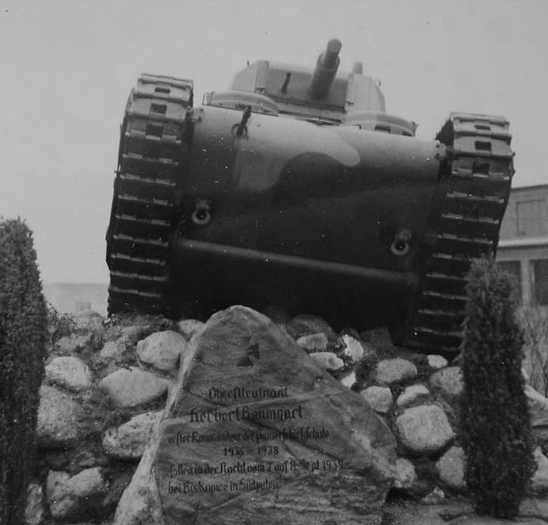

Behind the main crew compartment came the engine section, followed by a second, smaller turret. This rear turret sat lower than the roof of the engine section and therefore could not rotate fully – it was intended to cover only the area to the rear of the tank. A heavy machine gun, operated by the sixth and final crew member, was installed in it. The exact type of machine gun could not be determined, but it was evidently a water-cooled design, whose barrel jacket consequently resembled a gun barrel more than a machine-gun barrel.
According to some sources, one of the Daimler-Benz prototypes was later fitted with a longer-barrelled gun. This conclusion seems to have been drawn from a photograph of a Daimler Grosstraktor serving as a monument outside the barracks of the 5th Panzer Regiment in Wünsdorf. However, the question arises as to whether this is a genuine gun at all. Why would anyone go to the trouble of fitting a new gun type into a tank destined to stand on a plinth as a memorial? It seems far more logical to remove the gun entirely, use it elsewhere, and replace it with a dummy barrel for display purposes. One could argue that a new gun might have been installed during an earlier phase of prototype modification, long before the decision was made to convert the vehicle into a monument. Yet this seems unlikely, since the Daimler prototype was withdrawn from trials early due to persistent mechanical problems, and its armament was certainly not where improvements were needed. Incidentally, photographs also exist in which the gun has been completely removed from the Daimler Grosstraktor's turret, leaving only the tube that formed the inner section of the barrel projecting from the mantlet.

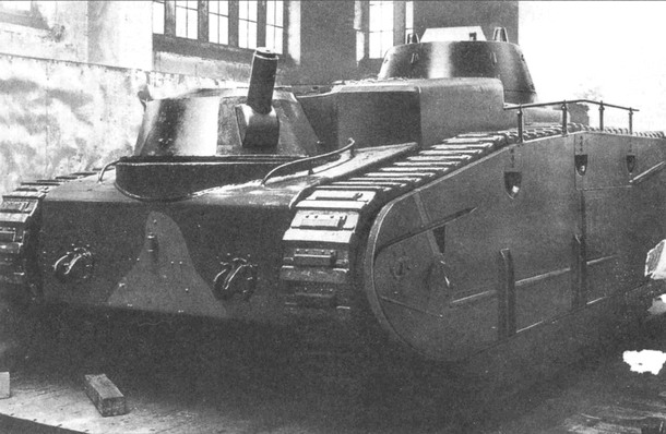

Rear view of the Daimler-Benz Grosstraktor, source: forum.worldoftanks.eu, edited

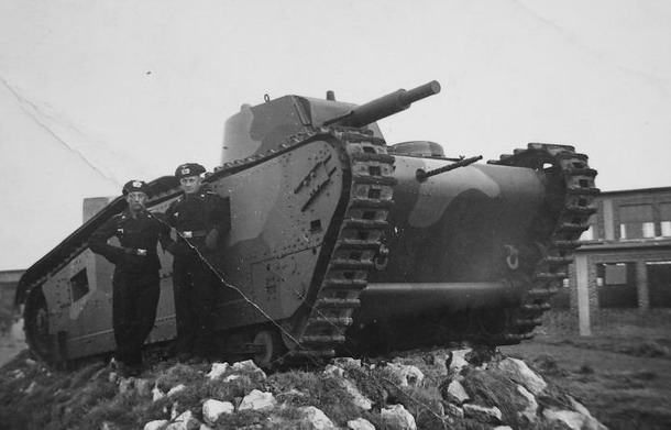

Krupp Prototypes
As is now clear, the Krupp Grosstraktor received the designation III. Krupp delivered its vehicles in 1928 and 1929. The running gear consisted of 12 small road wheels paired into bogies on each side, plus a further 2 or even 4 independent wheels. The rear wheel was the drive sprocket, the front the idler, and the upper run of the track was carried by the customary trio of return rollers. Here too the hull sides were covered by a large armour plate, though unlike the other two designs, Krupp left the drive sprocket entirely uncovered. The powerplant was, as in Grosstraktor II, the BMW Va aero engine. The weight of the Krupp prototypes was between 16 and 16.4 tonnes.
The armour thickness was identical across all three manufacturers' prototypes, ranging from 6 mm on the floor plates to 13 mm on the front hull. Ammunition stowage was also reportedly the same for all: 104 rounds for the 75 mm gun and 6,000 rounds for the machine guns. As for maximum speed, all Grosstraktors met or exceeded the Army's requirement of 40 km/h. The question of swimming capability remains highly contentious. According to the literature, propulsion during swimming was to be provided by propellers at the rear of the tank. Photographs of the rear of Grosstraktor vehicles (for example HERE, HERE, or HERE) reveal no sign of propellers whatsoever. And yet some authors go so far as to state that swimming trials did take place – and that one of the Rheinmetall prototypes actually sank during such trials in October 1929!
