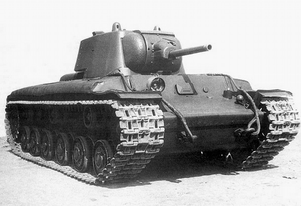

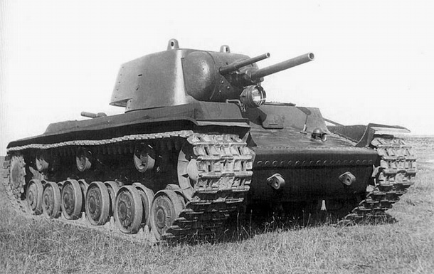

At the S. M. Kirov Plant in Leningrad, development of the SMK and its single-turreted rival — which received the designation KV, standing for the initials of the powerful Soviet marshal Kliment Voroshilov — proceeded in parallel. N. L. Dukhtsov was appointed chief designer of the KV. Development of the vehicle proceeded at a genuinely record pace. Design work began on 1 February 1939 (even before official approval), the technical design and a mock-up were completed by 7 April, and by 1 September the first prototype had been assembled and factory trials had begun.
KV tank prototype still armed with two guns, source: Aviarmor.net with permission of the operator, modified

The prototype — and the later production tanks derived from it — had a suspension consisting of six road wheels on each side. The wheels were twin, all-metal, and featured indentations and small circular lightening holes. The road wheels were evenly spaced and each was independently suspended and sprung by a swing arm connected to a torsion bar. At the front of the running gear was a spoked idler wheel, and at the rear a large toothed drive sprocket. Three evenly spaced return rollers supported the track from above. Track width was 70 cm.
The hull, whose individual sections were joined primarily by welding, sat on the running gear. The nose of the hull was formed by two plates meeting at a sharp angle (87°). The lower plate was 75 mm thick and angled at 30° from vertical. The upper plate was 40 mm thick and set at 63°. Two heavy towing eyes were fitted to the lower plate. The upper plate carried the mounting for the radio aerial rod. From the upper nose plate rose the frontal wall of the driver's compartment, angled at 30° with 75 mm of armour. In the centre of this plate was the driver's rectangular vision port, which could be closed by a shutter in dangerous conditions, leaving only a narrow slit for forward observation. A headlamp was installed to the right of the port. The prototype did not yet have a hull machine gun; this was only introduced on the production tanks. On production tanks, add-on armour up to 35 mm thick was also quite frequently welded directly onto the driver's frontal plate.
In the left section of the driver's compartment roof was a circular driver's hatch, closed by a single-piece lid. The compartment roof — ahead of the turret and for a short distance behind it — was 40 mm thick. Above the engine compartment it was "only" 30 mm. The floor armour followed a similar pattern: the front half was 40 mm thick, thinning to 30 mm under the engine compartment. It is worth noting that the most modern German tank of the time, the PzKpfw IV Ausf. D, produced from September 1939 onwards, had frontal hull armour of the same thickness as the engine compartment floor of the Soviet KV-1 — 30 mm. The exposure of these two surfaces to enemy fire is, of course, incomparable.

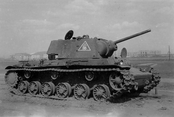

destroyed KV-1 with L-11 gun, source: Waralbum.ru with permission of the operator, modified

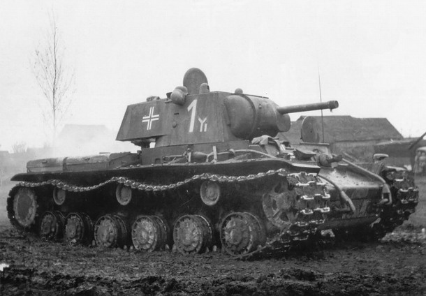

KV-1 with F-32 or F-34 gun, captured and pressed into service by the German 8th Panzer Division, source: Waralbum.ru with permission of the operator, modified
Before being sent to the front, the weaker of the two guns was removed from the KV prototype, as testing had shown that two guns were more hindrance than help and complicated the crew's work inside the turret. On 13 December the tank was therefore dispatched to Finland armed with a single 76.2 mm gun and a coaxial DT machine gun of 7.62 mm calibre. Together with the other two test prototypes, the SMK and T-100, the KV formed a heavy tank test company under the 91st Tank Battalion, which was part of the 20th Heavy Tank Brigade normally equipped with T-28 tanks. The KV's crew consisted of three men from the Leningrad factory and two officers from the 20th Heavy Tank Brigade. A special commission was present to observe how the tank performed in combat conditions.

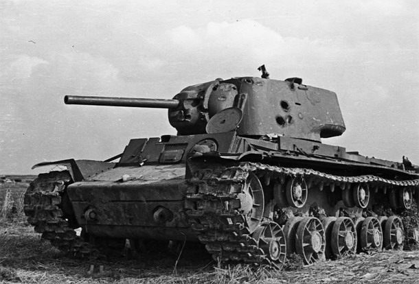

destroyed KV-1 with ZIS-5 gun, source: Worldwarphotos.info with permission of the operator, modified
Another suggested improvement came out of experience with Finnish fortifications. The 76.2 mm gun simply was not powerful enough to demolish them, so a proposal was made to build an experimental variant armed with a much heavier weapon capable of destroying reinforced concrete emplacements. This proposal resulted in the KV-2, armed with a 152 mm howitzer and described separately. During development it was not yet referred to as the KV-2 — it was simply called the KV with the large turret, or the KV with the MT-1 turret. The original KV was then logically called the KV with the small turret. The official KV-1 and KV-2 designations were not adopted until January 1941.

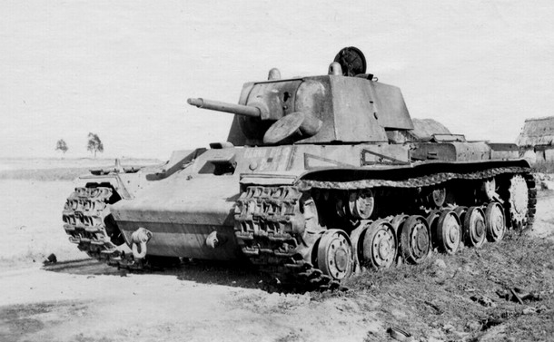

destroyed KV-1 with ZIS-5 gun and cast turret, source: Topwar.ru with permission of the operator, modified
The first production tanks were armed with the L-11 gun of 76.2 mm calibre. Their weight was 43 tonnes (sometimes quoted as 43.5 t) and their maximum speed 35 km/h. A 600-litre fuel supply allowed a range of around 250 km. Sources unfortunately disagree on whether these early tanks were designated Model 1939 or Model 1940; there is similarly conflicting information about the designations of subsequent variants and the differences between them. What is clear, however, is the sequence of changes that took place during production: principally upgrades to the armament and a gradual increase in armour thickness and weight.
In November 1940, more modern guns began to be fitted. The original L-11 was replaced by the F-32, of the same calibre. However, there were not enough F-32 guns to keep pace with tank production, so F-34 guns — otherwise used in the T-34 — were also fitted. Tanks from this production batch are referred to as the Model 1940 by some authors and the Model 1941 by others. During 1941, trials were conducted with a new cast turret; firing tests showed conclusively that the cast turret was more resistant than the welded version. The cast turret's armour was 95 mm thick and, while it improved protection, it also increased the tank's weight. For the remainder of 1941 both turret types were produced in parallel.

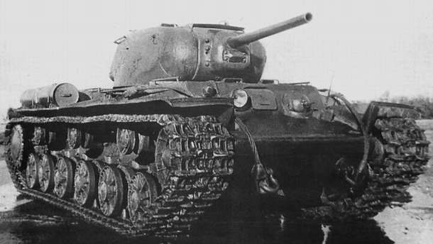

The "Fast" KV-1S
The cast turret improved protection but added weight. Combined with the add-on armour that was fitted to the driver's and radio operator's frontal plate on late-production tanks, this meant that later KV-1s weighed as much as 47.5 tonnes — with the predictable consequence of reduced speed. Soviet designers set to work finding a way out of the vicious cycle of increasing armour and decreasing mobility. The result was the modernised variant designated KV-1S.
The starting point for the modernisation was a thorough analysis of KV tanks hit in combat. The designers identified which areas were most frequently struck and which were hit least often. On that basis they proposed an optimised armour distribution — thicker where it mattered most, and reduced where it could afford to be. The lower nose plate was thinned from 75 mm to 60 mm. The upper nose plate was conversely thickened from 40 mm to 50 mm. The driver's frontal plate remained at 75 mm. The hull floor was 30 mm throughout, and the hull sides were 60 mm. The cast turret had a frontal wall 82 mm thick, side walls of 75 mm and a 40 mm roof.
modernised KV-1S tank, source: Topwar.ru with permission of the operator, modified
This weight-saving regime brought the tank down to 42.5 tonnes. Thanks to this reduction and improvements to the transmission, speed increased to 43 km/h — which, after all, gave the tank its name: the letter S stood for "Skorostnyj", meaning "fast". The tank also received new tracks 608 mm wide (compared to 700 mm on the original KV-1). Another new feature was a commander's cupola, positioned in the right rear section of the turret. The rear turret machine gun mount moved from the centre to the right side so that the tank commander could operate it. The junior mechanic, previously assigned to that gun, could now take over the loader's role and relieve the previously overburdened commander.

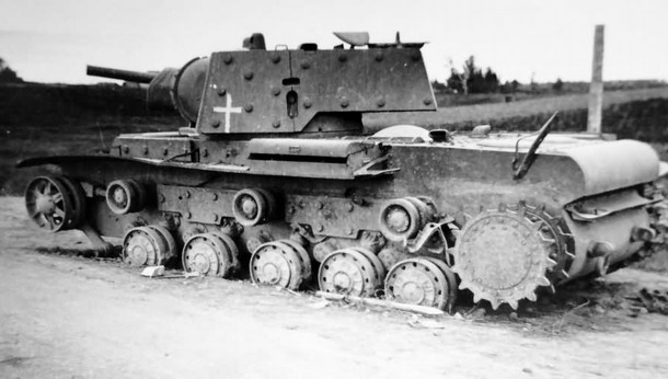

The Armoured KV-1E

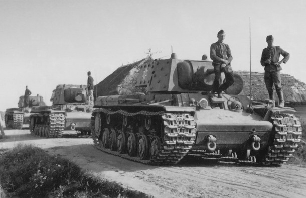

Another interesting but unofficial KV-1 variant emerged in the summer of 1941. As the KV-1 saw its first combat against German opponents, reports began arriving that the Wehrmacht was deploying powerful 88 mm anti-aircraft guns in an anti-tank role, and that Soviet tanks were unable to withstand them. Add-on armour plates were therefore fitted to tanks already in service. Steel strips were welded onto the original armour on the turret sides, threaded holes were drilled into them, and armour plates 20 to 35 mm thick were then bolted on.
Tanks modified in this way were unofficially designated KV-1E and were very easy to identify by the large bolt heads decorating the sides of their turrets. The add-on plates had cutouts for the side vision slits and pistol ports. Only turrets with a squared-off rear were modified in this way. In addition to the turret sides, small add-on armour plates were also fitted to the sides of the hull between the road wheels and the upper return rollers. The letter E in the designation abbreviated the word "Ekranirovanyj", meaning "screened" or "up-armoured". The KV-1E was never officially approved, however, and existed only as a field modification of tanks already in service. In fact, the opposite came to pass: the fitting of supplementary armour was eventually officially banned, as the increased weight of the KV-1E led — beyond the expected drop in speed — to a higher rate of mechanical failure in heavily stressed components.

three KV-1E tanks pressed into German service, source: Waralbum.ru with permission of the operator, modified

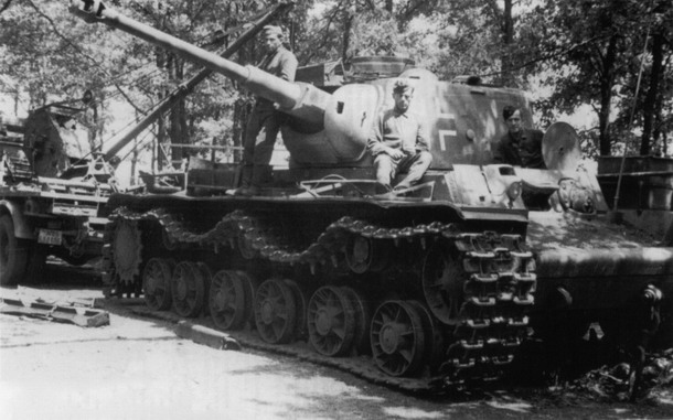

KV-1 fitted with the German KwK 40 L/43 gun of 75 mm calibre, source: Waralbum.ru with permission of the operator, modified
