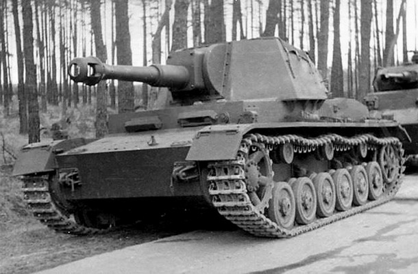

the Sd.Kfz. 165/1 offered a generous lateral traverse for the gun; note also the periscopic sight protruding from the turret, source: Flickr.com with permission of the publishing user

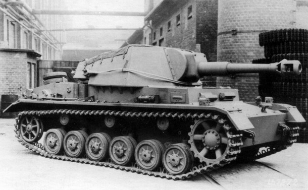

As noted above, the new self-propelled gun was built on the Panzer IV Ausf. F chassis, which had been fundamentally redesigned for this purpose — even more so than for the Dicker Max. The front drive sprocket and rear idler wheel were taken over without modification. Between them, however, were only six road wheels — compared to eight on the Panzer IV. Moreover, these were not wheels taken from the original tank, even though they appeared identical at first glance. The road wheels of the Panzer IV Ausf. F had a diameter of 470 mm, whereas those used on the Pz.Sfl. IVb were 520 mm. The need for custom-made wheels undoubtedly added to costs. One might ask why the designers did not simply borrow the road wheels from the Panzer III (from the Ausf. E onwards), which also had a diameter of 520 mm. Those wheels were designed for tracks only 360 mm wide, but one might still expect that widening them would have been cheaper than manufacturing entirely new wheels.
The smaller number of road wheels — even if slightly larger — makes it clear that the self-propelled gun's chassis was somewhat shorter than the original tank's (by approximately 35 cm according to some sources). This in turn allowed a reduction in the number of return rollers supporting the upper run of the track — the Panzer IV Ausf. F had four, but the Pz.Sfl. IVb only three. The 400 mm wide tracks, on the other hand, were taken from the tank without modification. Road wheel suspension used leaf springs, as on the Panzer IV. The hull and crew superstructure closely resembled the original tank in outward appearance, but were by no means the same construction. The armour thickness alone tells the story: the PzKpfw IV Ausf. F had 50 mm frontal armour, whereas the Pz.Sfl. IVb had a mere 20 mm. The designers sensibly concluded that a self-propelled gun, given its intended role, did not need extremely thick armour — it was enough for the plates to withstand armour-piercing rounds from rifles and machine guns of 7.92 mm calibre. The weight saved was put to good use by mounting a heavy weapon.
At the Army's request, two vision ports were provided in the front wall of the crew superstructure. The left one was real and served the driver; the right one was false, apparently intended solely to deceive the enemy. The driver was therefore the only crew member seated in this section of the superstructure, and he accessed his seat through his own roof hatch. Further rearward, mounted on the superstructure roof, was a fighting turret — yes, this early self-propelled gun had a rotating fighting turret, even if its traverse was far from a full 360 degrees. The front wall of the turret was its highest point; the sides tapered downward toward the rear, ending at a relatively low rear wall. The turret roof was left open, which was considered an appropriate solution for a self-propelled gun. An open roof would have been a risk in close combat — an enemy infantryman could easily throw a grenade into the vehicle — but this type of engagement was not expected for a self-propelled artillery piece. Conversely, an open roof provided a better view of the sky, essential for observing shell bursts and correcting aim.

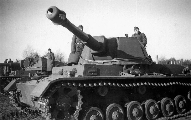

Sd.Kfz. 165/1 during driving trials, source: Flickr.com with permission of the publishing user

The vehicle's crew consisted of four men. The driver, as already noted, sat alone inside the hull; the remaining three had their stations in the turret. To the left of the gun sat the gunner, who had a choice of two sights: the Sfl.Z.F.1a for direct fire and the Rundblickfernrohr 36 panoramic sight for indirect fire. Behind the gunner, on a raised seat, sat the vehicle commander, who also operated the radio. His primary observation tool was the binocular artillery scissors periscope Scherenfernrohr 14 Z f.Sfl. The fourth crew member was the loader, stationed to the right of the gun. The vehicle had no built-in secondary armament, though the crew carried two MP 38 or MP 40 submachine guns.

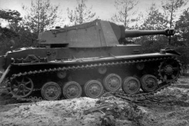

the Geschützwagen IVb für 10,5cm leFH 18/1 was ahead of its time in many respects, source: Flickr.com with permission of the publishing user

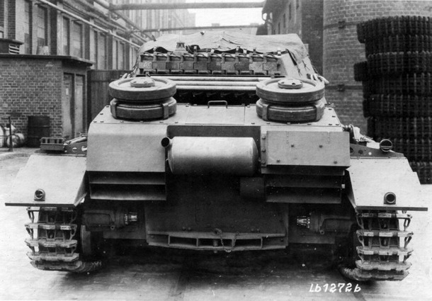

rear view of the Geschützwagen IVb für 10,5cm leFH 18/1, also known as the Sd.Kfz. 165/1, source: Flickr.com with permission of the publishing user
