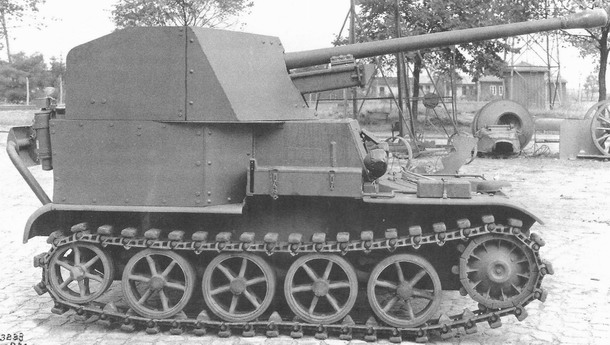

One of the two prototypes of the Panzerselbstfahrlafette Ia 5 cm Pak 38 auf Gepanzerter Munitionsschlepper tank destroyer. Source: Flickr.com, with permission of the publishing user, edited

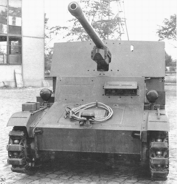

Panzerselbstfahrlafette Ia 5 cm Pak 38 auf Gepanzerter Munitionsschlepper. Note the blanked-off right vision port. Source: Flickr.com, with permission of the publishing user, edited

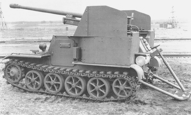

Panzerselbstfahrlafette Ia 5 cm Pak 38 auf Gepanzerter Munitionsschlepper. Note the driver's side entry door and the folded rear support leg. Source: Flickr.com, with permission of the publishing user, edited

The running gear inherited from the VK 3.02 consisted of four road wheels on each side. These were spoked wheels with a massive rubber tyre around the circumference. Each wheel was suspended on its own swinging arm and sprung by a torsion bar. At the very rear was an idler wheel closely resembling the road wheels in design but smaller in diameter. Both the road wheels and the idler were double -- formed from a pair of discs -- with the track's guide horn passing through the gap between the discs. The drive sprocket was at the front. The tracks were 200 mm wide and fitted with rubber pads for smoother travel on hard surfaces. The vehicle was powered by a Borgward 6M 2.3 RTBV petrol six-cylinder of 2.247 litres displacement, producing a maximum of 49 horsepower.

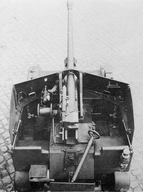

The original crew compartment from the VK 3.02 was retained with certain modifications. Only the driver's station on the left was kept, however. The position of the second crew member from the original VK 3.02 was eliminated and the space used for gun ammunition storage -- which also made it possible to blank off the right-hand vision port in the front wall of the cab. The original roof hatches in the cab likewise had to be removed: the right one was no longer needed at all, and the left one -- used by the driver -- was replaced by a door in the left side wall. The roof hatches could not remain because the gun's front shield now rested there, which would have prevented them from opening. Behind the cab, a new fighting compartment was created for the gun crew. Its lower portion was protected by a fixed surround of armour plate reaching to the height of the driver's cab roof. Above this fixed surround, a moveable armour shield that traversed laterally with the gun barrel provided protection. This shield covered the front and sides only -- the rear and top of the fighting compartment remained open.
The raised engine cover ran along the centre of the fighting compartment, dividing it -- together with the gun itself -- into two halves, each containing a seat for one soldier. To give both men sufficient room, the fighting compartment armour was widened to the outer edge of the track mudguards. The gunner, who also served as vehicle commander, sat to the left of the engine and gun. The loader sat to the right of the weapon. The gun mounting allowed horizontal traverse of 20 degrees to each side. Vertical elevation ranged from -10 to +20 degrees.

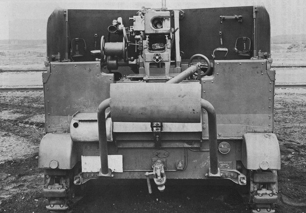

Panzerselbstfahrlafette Ia 5 cm Pak 38 auf Gepanzerter Munitionsschlepper. Source: Flickr.com, with permission of the publishing user, edited

The designers nonetheless managed to keep the vehicle's total weight to 4.5 tonnes, which was apparently an acceptable figure. Maximum speed was around 30 km/h. The crew, as already indicated, consisted of three men. The driver sat alone inside the hull and observed through his main vision port in the wall in front of him and through a side port in his entry door. The other two crew members sat in the open fighting compartment, which they entered over its lowered rear wall -- assisted by a step positioned above the exhaust silencer.

A view into the fighting compartment of the Panzerselbstfahrlafette Ia 5 cm Pak 38 auf Gepanzerter Munitionsschlepper tank destroyer. Source: Flickr.com, with permission of the publishing user, edited
The energy generated by firing the gun placed considerable strain on the chassis. To relieve this stress and to stabilise the vehicle during firing, the designers fitted a support leg at the rear of the hull that was folded down and braced against the ground before firing began. None of the sources mention any communications equipment, and no radio aerial is visible in any of the photographs. If the tank destroyer was indeed not fitted with a radio, this would have been a fairly serious handicap.
