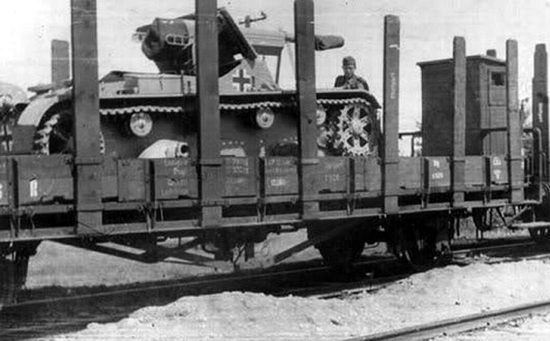

7.5 cm PaK 97/38 auf Pz. 740(r) during rail transport; this photograph clearly shows how little armour protection the gun crew had, source: Flickr.com with the permission of the publishing user, edited

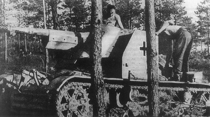

7.5 cm PaK 97/38 auf Pz. 740(r) on "display" at a Panzerjäger-Abteilung (Sfl.) 563 equipment show, source: Flickr.com with the permission of the publishing user, edited

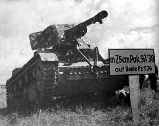

The battalion's workshop commander appears to have been an enterprising man who wanted to do something to help his comrades. The battalion apparently had a supply of the aforementioned 7.5 cm Pak 97/38 anti-tank guns, and had also somehow managed to obtain several obsolete but serviceable ex-Soviet T-26 tanks (which may at that point have been used within the battalion as unarmed cargo tractors). Combining the two was not particularly complicated. The turret was removed from the light tank (if the examples used still had their turrets at all) and the compartment beneath it was stripped of its roof and rear wall. The gun mount was bolted either to the side walls of the original compartment, to its floor, or to both.
Vehicle Description

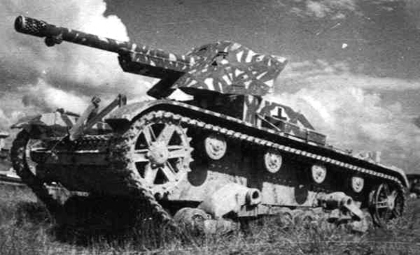

The gun was installed in the vehicle complete with its shield, which then provided virtually the only protection for the gun crew. Photographs show, however, that at least two vehicles received additional side armour after the fact. In one case this amounted to an extension and raising of the original compartment's side wall (photo HERE); in the second, large plates were fitted to the sides to form a new solid side armour (photo HERE). The vehicle's crew probably consisted of three men. The driver sat inside the hull, protected by the front and side walls of the original tank hull, but with an open fighting compartment behind and above him where the other two crew members were seated. The gunner and commander in one – who occupied the left side of the gun – and the loader on the opposite side of the weapon. Ammunition for the gun was stored in a large wooden or metal box on the right-track fender and probably also inside the fighting compartment itself.
The engine, gearbox, fuel tanks, running gear and other internal components were taken over from the original T-26 tank, meaning the vehicle was powered by the petrol engine known simply as the T-26 engine, with a maximum output of 95 horsepower. The improvised tank destroyer is most commonly referred to in accordance with German nomenclature as the 7.5 cm PaK 97/38 auf Pz. 740(r). Only 10 examples of this fighting vehicle were produced, with the last probably completed in October 1943. All were assigned to the 3rd Company of the aforementioned Panzerjäger-Abteilung (Sfl.) 563, where they served until March 1944, when they were replaced by the full-specification Marder III tank destroyers.

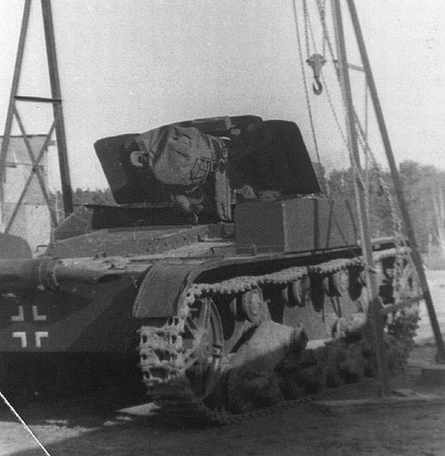

this photograph finally gives a clear view of the large (probably wooden) ammunition box stored on the right-track fender, source: Flickr.com with the permission of the publishing user, edited

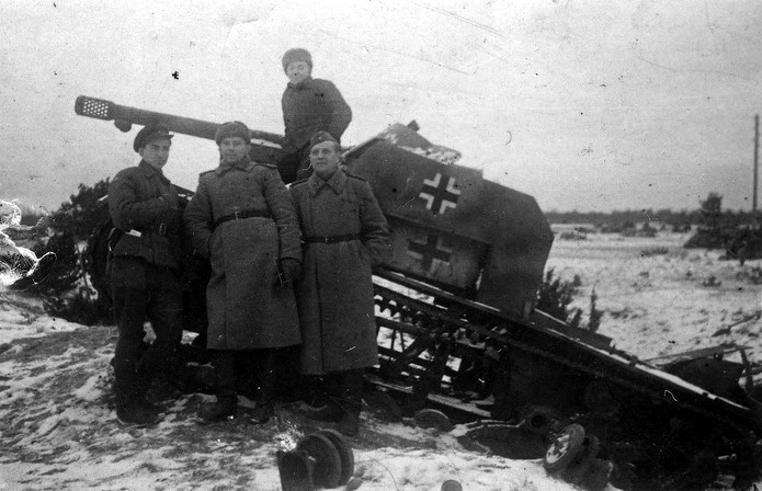

On 29 September 1944, the Red Army launched an attack on the entire West Estonian Archipelago (also known as Moonsund). During the fighting that followed, an engagement took place near the village of Tehumardi. This village lies at the base of a narrow strip of land connecting the main island of Saaremaa to the small Sõrve Peninsula in the south-west. The remaining German units, retreating before the Red Army, were attempting to reach this peninsula. On 8 October 1944, approximately 750 men of the German 67th Potsdam Grenadier Regiment were also trying to pass through. However, a similar number of soldiers from the Estonian 249th Rifle Division had got there ahead of them. Neither side had any idea of the other's presence, and when the Germans arrived at the location in the night of 8–9 October, the Estonians almost let them pass, thinking they were another Red Army formation. But when it became clear who was who, a very confused close-quarters battle broke out in the darkness.
The Germans lost approximately 200 men (as did their opponents), but managed to push through, and at least some of them may have been evacuated in November. The day after this night battle, however, Estonian soldiers found among the debris on the battlefield one particularly interesting destroyed vehicle: an improvised tank destroyer, the 7.5 cm PaK 97/38 auf Pz. 740(r). The wreck was fairly heavily damaged, yet even in the photographs taken of it the additional side armour on the fighting compartment is clearly visible. As for the fate of the remaining nine vehicles of this type that were built, we unfortunately know nothing. For the sake of completeness it should be noted that the 7.5 cm PaK 97/38 auf Pz. 740(r) on display at the private Vadim Zadorozhny Museum at Arkhangelskoe near Moscow is not a surviving original but a newly built replica.
