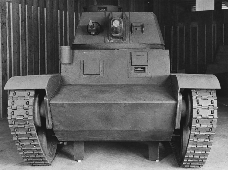

Full-scale wooden mock-up of the T-15 in its original form – note the front wall of the turret and the vision ports in the hull, source: Regional Archives in Plzeň, 4th Department

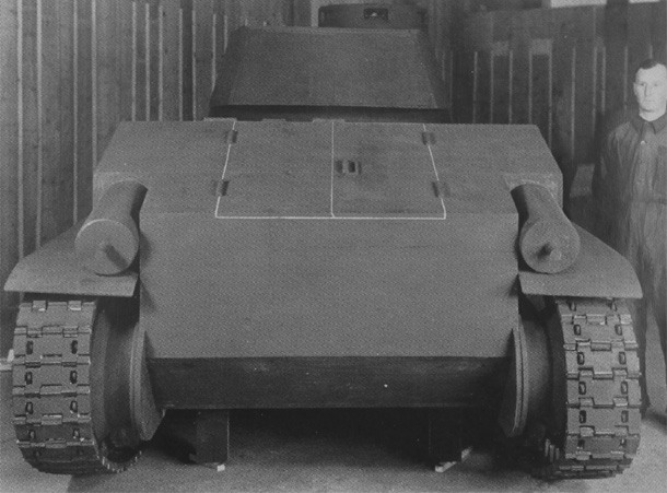

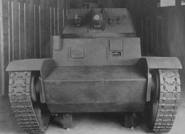

Škoda's answer to the German requirement described above was a prototype tank designated T-15. By the end of 1940 the engineers had completed drawings of the new vehicle, and in January 1941 a full-scale wooden mock-up was constructed. The first functional prototype was to be delivered in October or November 1941, and if the Army accepted the design, production was to begin the following year.

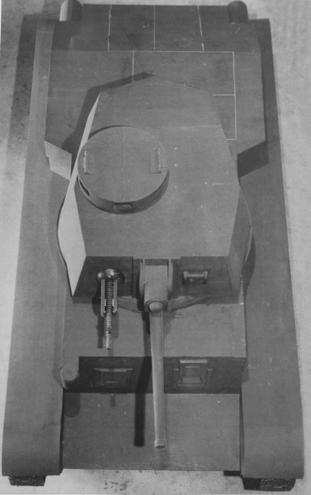

The initial T-15 design made no secret of its inspiration from the PzKpfw 38(t). The front hull section was handled in almost exactly the same way, the only difference being the absence of a hull machine gun in the front wall of the crew compartment – one was not required on the new vehicle. The front face of the fighting turret was also approached in a very similar manner to the older type. The same gun (Škoda A7, 37 mm calibre) and machine gun (ZB vz. 37, 7.92 mm calibre) were used, mounted in identically designed cradles. However, an early review of the technical drawings and the wooden mock-up quickly led to significant redesign of the fighting turret, which reduced the similarity to the PzKpfw 38(t). The originally angled rear turret wall was replaced by a simpler flat wall, and the turret received a single combined mantlet mounting both the gun and the machine gun. The mantlet was cylindrical in shape, similar in design to that used on later versions of the Panzer III.

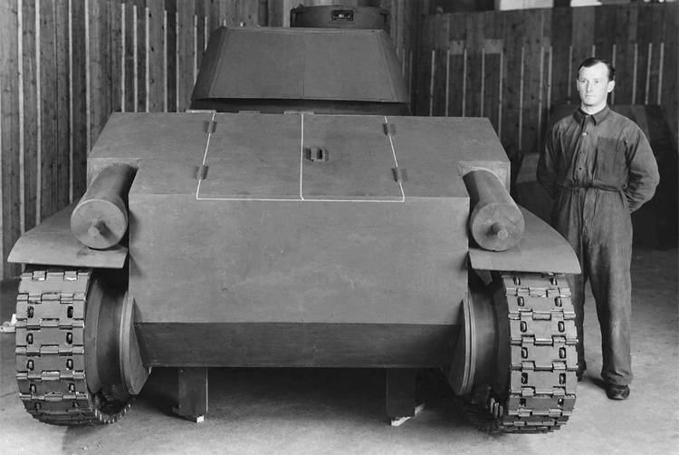

The tank gun A7 also had to be adapted to fit the new mantlet. Its modified version received the designation A19, though it remained essentially the same weapon. The machine gun type, however, was changed: instead of the Czechoslovak ZB vz. 37, the German MG 34 of 7.92 mm calibre was to be fitted.

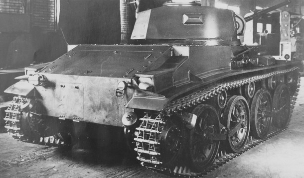

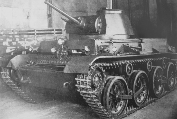

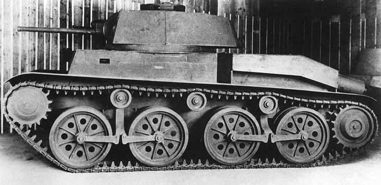

The first T-15 prototype was completed in October 1941, with the second following in December of the same year. The running gear of the new tank consisted of four road wheels on each side, 726 mm in diameter and fitted with solid rubber tyres around their circumference. The wheels were of double-disc construction, with the track guide teeth engaging between the two discs. The wheel discs were reinforced by spokes, between which lightening holes were cut. The wheels were suspended on swinging arms, including from the outside. The arms of two adjacent wheels converged toward each other and were connected to two shared leaf springs – one positioned between the first and second wheels, and one between the third and fourth. The front pair of road wheels was thus sprung by one leaf spring and the rear pair by the other.
At the front of the running gear was a toothed idler wheel 485 mm in diameter; at the rear was a drive sprocket with a diameter of 574 mm. The upper run of the track was supported by three return rollers spaced evenly above the gaps between the road wheels. The tracks were 270 mm wide. At first glance, the suspension and wheel arrangement appeared to be a step backward toward the complex systems of interwar tanks. In truth, the mechanism was relatively straightforward. Nevertheless, it once again proved that mounting these elements on the outside of the running gear created more problems than benefits. The external swinging arms were vulnerable to enemy fire – a hole through a road wheel will not stop a tank, but a shot-off suspension arm certainly complicates matters – and they could also be damaged during cross-country driving, by rocks, tree stumps, and similar obstacles. Testing of the T-15 prototype also revealed that dirt was finding its way into the exposed outer wheel bearings.
Full-scale wooden mock-up of the T-15 in its original form, source: Regional Archives in Plzeň, 4th Department
The engine compartment occupied the rear of the hull. The tank was powered by a Škoda T-15 petrol eight-cylinder engine of 10.8 litres displacement, producing a maximum output of 220 hp at 2,800 rpm. One exhaust pipe ran along the track mudguard on each side of the engine compartment, with its outlet directed towards the rear of the vehicle. The gearbox offered six forward and reverse speed ratios, meaning that in theory the tank could reach the same speed going backwards as forwards. Maximum road speed was around 60 km/h, in line with the Army specification. As for fuel capacity, different sources give varying figures; the highest quoted is 300 litres of petrol stored in two tanks, giving a range of 250 to 280 kilometres.
The hull was welded from flat armour plates of varying thickness. The front wall of the crew compartment rose from the hull nose. Two vision ports for the driver and radio operator – seated behind this wall – were cut into it. In the original design (and on the wooden mock-up) these ports were closed by square sliding covers, but the prototypes were fitted with oblong solid-flap covers instead. These flaps appear to have been set to become the standard solution in the German Army, as they were also used on the competing prototypes from MAN and BMM, and can be found on other contemporary light tank projects such as the PzKpfw I Ausf. C and PzKpfw II Ausf. G.
The driver (seated on the left) and radio operator (on the right) also had vision slits in the side walls of the crew compartment, one on each side. Above the head of each of these crew members, an individual access hatch was cut into the roof of the compartment, ahead of the turret. The remaining two men on board had their stations in the fighting turret. The turret had a flat front and rear wall with rounded sides, and was slightly conical – tapering gently upward on the sides and at the rear. Almost the entire front plate was occupied by the combined gun mantlet already described. The barrel of the 37 mm A19 gun passed through the centre of the mantlet, with the gun sight outlet to its left. The MG 34 machine gun was mounted to the right of the gun. Ammunition stowage comprised 78 rounds for the gun and 2,100 rounds for the machine gun.

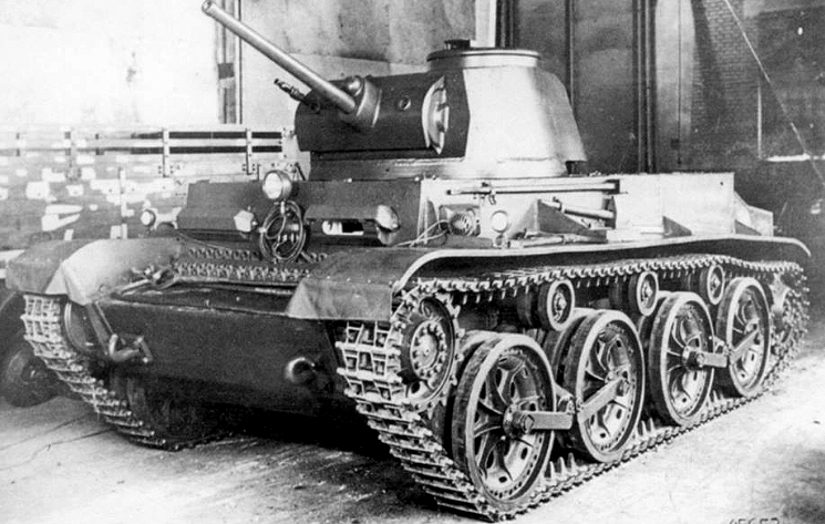

T-15 prototype, source: Regional Archives in Plzeň, 4th Department
The right side wall of the turret contained a single vision slit. No observation openings were provided in the rear wall or on the other side. A raised commander's cupola was fitted on the turret roof. It contained a single-piece hatch cover serving both the commander and the gunner – the two men stationed in the turret. Unlike most contemporary German tanks, the commander's cupola was not provided with vision ports around its circumference; instead, a periscope was installed in the forward part of its roof. Logic would suggest that the cupola roof – with its periscope – would be rotatable, allowing the commander to observe the full area around the vehicle. This cannot be confirmed from the available photographs, however, as virtually all of them show the periscope pointing forward.

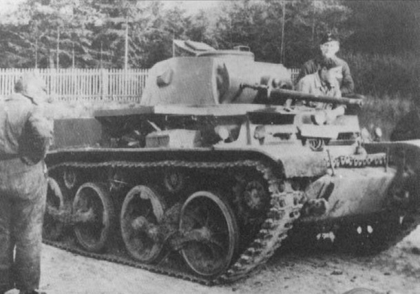

From March to June 1942, prototypes from all three invited manufacturers were put through their paces at the Kummersdorf proving ground. BMM (the former ČKD) submitted two examples of its design, designated TNH n.A., which was based on the older PzKpfw 38(t). MAN submitted a prototype designated PzKpfw II n.A. Škoda sent its prototype number two. The trial results were not encouraging. The report prepared by the evaluation board on 27 June 1942 summarised the problems that had appeared in the T-15 after covering a total of 4,022 km: damage to the crankshaft bearings, cylinder heads, and gearbox components. On the basis of the trials, the board assessed the tank as immature.
The wooden tank mock-up clearly had a very detailed running gear: Flickr.com with permission of the publishing user, edited
After the first phase of testing, the T-15 prototype was returned to the Škoda works for the identified deficiencies to be rectified – as were the prototypes of the other manufacturers. In October 1942 the final comparative trials took place. The ultimate verdict declared the MAN prototype the winner of the competition. The victorious tank subsequently entered history as the PzKpfw II Ausf. L, better known as the Luchs. The T-15 project was thereby consigned to oblivion.
