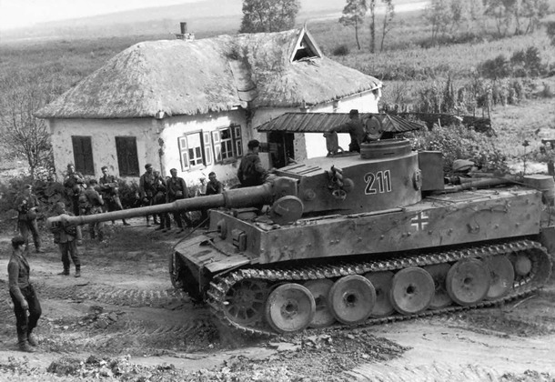

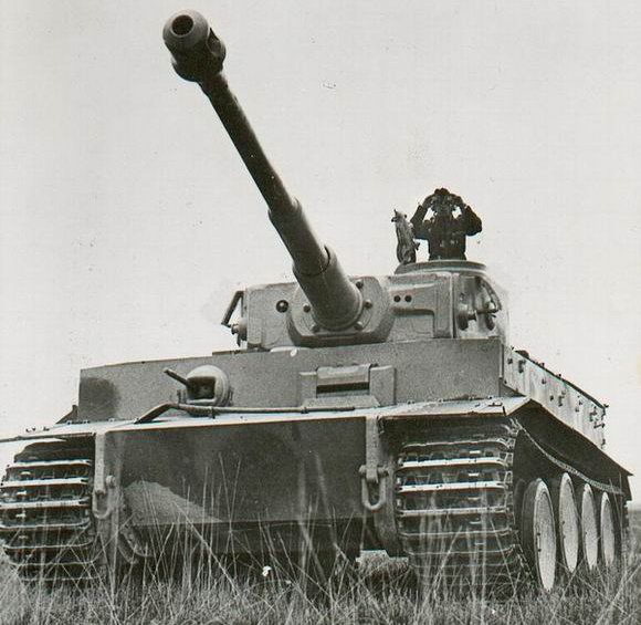

Panzerkampfwagen VI – Tiger, early production variant, source: Bundesarchiv_Bild_183-J05741, Wikimedia, Creative commons
The Tiger is beyond any doubt the most famous German tank of the Second World War, and one of the most iconic tanks in the entire history of armoured warfare. Its name has featured in virtually every war film ever made and has become a symbol of German tank technology — and all this despite the fact that, compared to other vehicles, relatively few were actually produced.

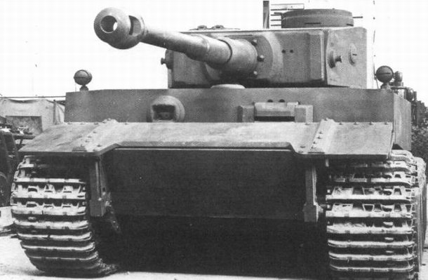

VK3001(H) prototype during trials, with concrete rings fitted in place of a turret, source: Flickr.com, courtesy of the publishing user
The Henschel running gear consisted of seven road wheels on each side. The wheels were doubled and interleaved — the inner and outer halves of alternating wheels meshed into the gaps between one another, so that when viewed from the side the wheels partially overlapped. The outer row contained three wheels, the inner row four. At the front sat a spoked drive sprocket and at the rear a spoked idler. Three return rollers, symmetrically spaced above the road wheels, completed the arrangement. The track rested on them from above.
Hull and running gear armour ranged from 35 to 50 mm. The powerplant was a six-cylinder petrol engine, the Maybach HL 116, with a displacement of 11 litres producing a maximum output of 300 horsepower at 3,000 rpm. The vehicle's maximum road speed was 35 km/h. Four prototypes were built in total and subjected to thorough testing over the following months. After the programme was cancelled, two of these hulls were used as the basis for a heavy tank destroyer designated 12,8cm Kanone 40 auf VK 3001 (H). For this new purpose they had to be lengthened and received an eighth pair of road wheels. The remaining two prototypes apparently served out their days as training vehicles.

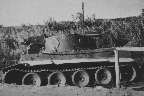

VK3001(H) prototype, source: Flickr.com, courtesy of the publishing user
In the case of VK3001 (P), the drive system consisted of two ten-cylinder Porsche 100 engines each producing 210 horsepower, two generators, and two Siemens electric motors. After the project was cancelled, the sole Porsche prototype presumably served out its remaining life as a training vehicle.

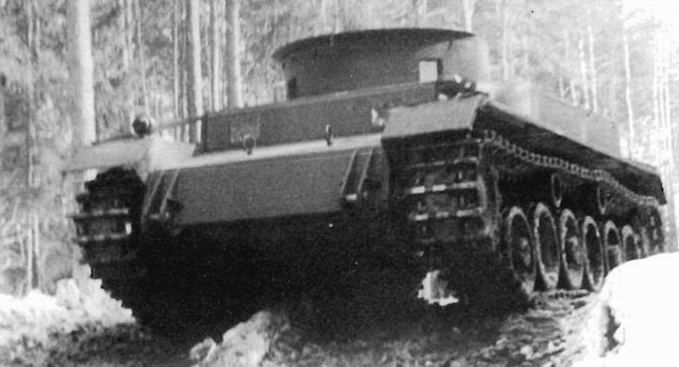

VK3001(P) prototype during trials, source: Flickr.com, courtesy of the publishing user

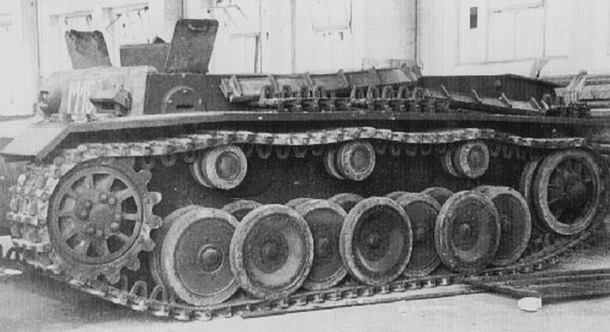

In early 1942, Henschel delivered its VK3601 (H) prototype for testing. It was again a hull and running gear assembly only, without a turret. The running gear on each side consisted of eight large-diameter road wheels. Each wheel comprised two discs. The discs of the odd-numbered wheels were mounted close together on the axle, while those of the even-numbered wheels had a gap between them — into which the odd-numbered wheels fitted. Viewed from the side, the wheels overlapped, and only the outer discs of the even-numbered wheels were visible as a continuous row. The road wheels were solid and fitted with rubber tyres around their circumference.
The system was completed by a simple idler at the rear and a massive drive sprocket at the front. No return rollers were needed, as the tracks rested directly on the road wheels from above. For the complete tank fitted with turret and armament, a weight of between 36 and 40 tonnes was anticipated. The intended powerplant was the twelve-cylinder Maybach HL 174, with a displacement of 19 litres and a maximum output of 550 horsepower.
A total of six VK3601 (H) vehicles were produced. After the decision against series production and the cancellation of the programme, they were converted into recovery vehicles. One of them was even fitted with a crane and apparently served in field repair workshops.

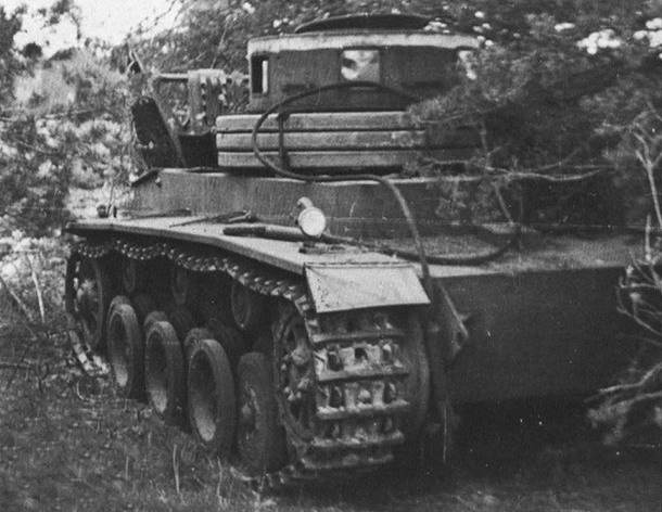

VK3601(H) during a test drive, source: Flickr.com, courtesy of the publishing user, edited

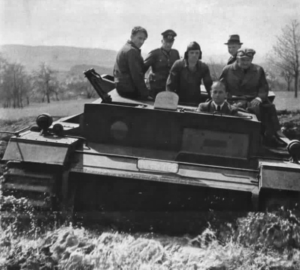

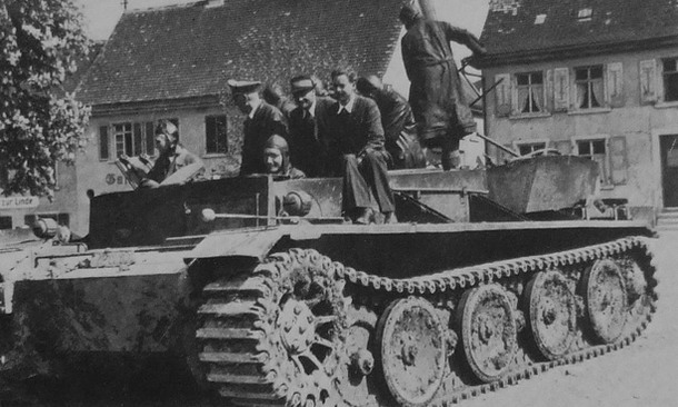

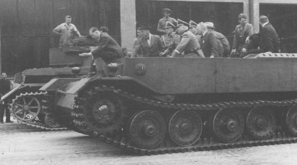

VK3601 (H) during a test drive — at the wheel is none other than Albert Speer, with Prof. Porsche seated behind him, source: Flickr.com, courtesy of the publishing user, edited

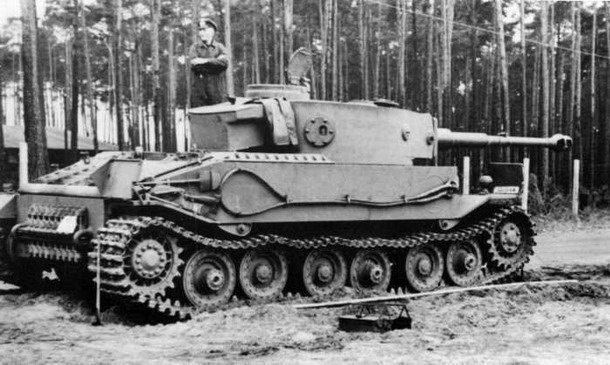

The VK4501 (P), sometimes also known as the Porsche Tiger, had a running gear consisting of six large all-steel road wheels on each side, suspended in pairs. The drive sprocket was at the front and the idler at the rear. The tracks rested directly on the road wheels from above. The tank's hull was assembled from welded flat armour plates. The frontal plate was 100 mm thick, the sides and rear 80 mm.
Porsche, as before, applied his characteristic petrol-electric drive system to this vehicle as well. The combustion element consisted of two ten-cylinder Porsche 101/4 engines each producing 320 horsepower, connected to two electric generators that supplied current to two electric motors. So equipped, the VK4501 (P) prototype was capable of reaching a maximum road speed of 35 km/h.
In addition to the turret armament, the vehicle carried a hull machine gun mounted in a hemispherical ball mount in the right side of the frontal plate. The crew consisted of five men: driver, radio operator/machine gunner, gunner, loader, and commander. The first two had their positions inside the hull; the remainder were in the rotating turret. The ammunition stowage for the main gun was 70 rounds. Fuel capacity was 520 litres, giving the tank a range of approximately 80 km.
For the Porsche team, the driving trials turned into a nightmare from the very start. No sooner had their tank rolled off the unloading ramp than it became stuck in soft ground and had to be ignominiously recovered by the rival vehicle. The VK4501 (P) continued to perform poorly for the remainder of the trials — the only area in which it exceeded the Henschel machine was cross-country top speed, and even on roads it could not match the Henschel in that regard. It is no surprise that the Porsche entry failed the trials.

tank PzKpfw VI Tiger
VK4501 (P) prototype, here already fitted with the Krupp turret, source: Flickr.com, courtesy of the publishing user, edited

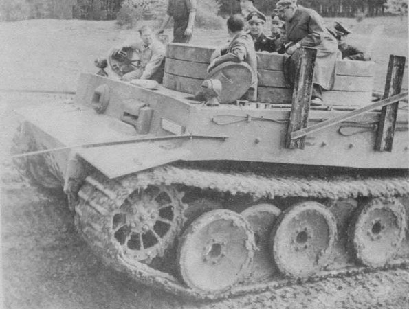

VK4501 (H) with concrete rings in place of a turret during driving trials, source: Flickr.com, courtesy of the publishing user, edited

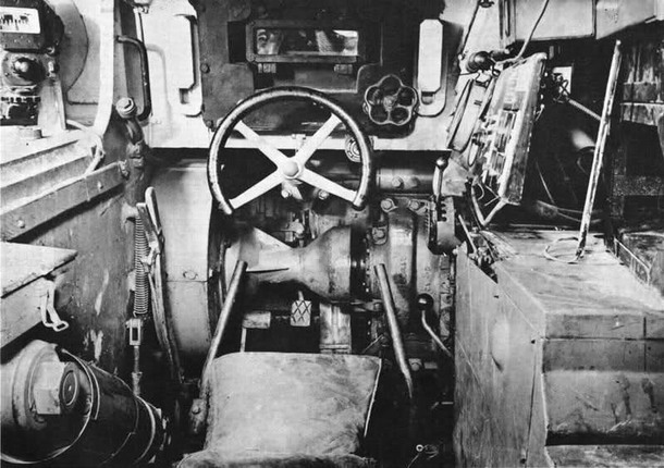

The frontal hull plate contained the driver's vision port, with a hemispherical ball mount for the hull machine gun to its right. The powerplant was located at the rear of the hull — a twelve-cylinder petrol engine, the Maybach HL 210 P45, with a displacement of 21.3 litres and a maximum output of 642 horsepower at 3,000 rpm. This unit was capable of propelling the vehicle to a top road speed of 45 km/h — a truly impressive figure given the vehicle's weight of 56.9 tonnes.
The fuel consumption was equally impressive, though in a less flattering sense. On roads, the twelve-cylinder engine consumed roughly 535 litres of petrol per 100 km; cross-country, this rose to as much as 935 litres. Four fuel tanks with a combined capacity of 534 litres gave the tank a road range of approximately 100 km, and a mere 60 km across country. The Maybach OLVAR OG 401216 A gearbox, located at the very front of the hull and connected to the engine by a driveshaft running beneath the floor, offered eight forward and four reverse gear ratios.
The crew again numbered five, in the standard configuration. The radio operator and driver sat in the forward hull section. Both entered the vehicle through their own circular hatches above their respective stations, each fitted with a periscope. In addition, the driver had a large closable vision port directly in front of him. He steered the vehicle using a steering wheel — somewhat unconventionally — with conventional brake levers available as a backup in the event of failure.

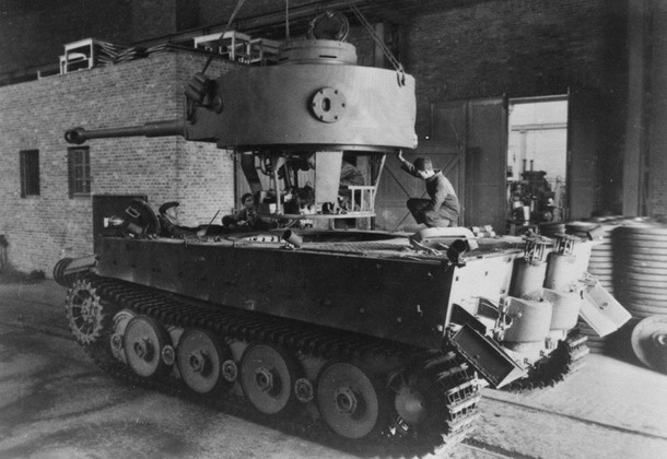

Krupp's Fighting Turret
The turret, a Krupp design, was conceived from the outset to be as low as possible in order to minimise the target area presented to enemy projectiles. This did impose some restriction on the gun's vertical arc of movement. The first eight turrets produced had lower side walls and a horizontal roof with a raised section — this bulge allowed the gun to be depressed more steeply, as it provided clearance for the breech end of the barrel to rise towards the turret roof. Later standard turrets were taller, with a flat roof plate that sloped forward, without the raised section.
The turret was rotated by an electric motor, controlled by the gunner via foot pedals. Manual traverse wheels were available to both the gunner and the commander in the event of an electrical failure.
The frontal turret plate was flat and 100 mm thick. The remainder of the turret was formed from a single steel plate 80 mm thick, bent into a horseshoe shape. The weapon carried in the turret was the highly capable KwK 36 L/56 gun in 88 mm calibre, derived from an anti-aircraft gun. The gun was fixed in the front vertical mantlet plate, which allowed it to be elevated and depressed within a range of -6.5° to +17°.

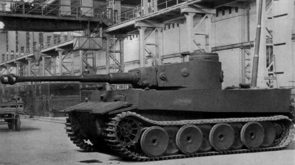

VK4501 (H) prototype in the Henschel factory hall, source: Flickr.com, courtesy of the publishing user, edited

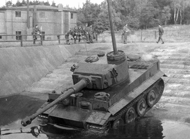

The first series-production tanks were standardly prepared for deep wading. The hull, turret, and turret ring were all fully sealed, and a metal tube was fitted before submersion to supply air and vent the engine exhaust (a Tiger prepared for underwater travel is visible in the photograph below). The Tiger was thus capable of driving through water up to four metres deep. No documented instance of this capability being used in actual combat is known, however, and the deep wading preparation was eventually discontinued in production vehicles.

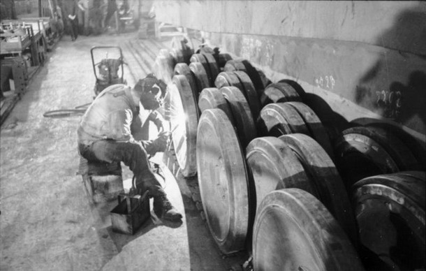

A Complex Running Gear
The intricate interleaved wheel arrangement used on original Tigers — 48 wheels in total — allowed the vehicle's enormous weight to be distributed more evenly and gave it a smoother ride and easier handling, but it brought with it one serious practical problem. When driving cross-country, stones were relatively easily drawn into the road wheels and became jammed in the narrow gaps between them, often resulting in deformed wheels or damaged axles requiring laborious replacement.
On the Eastern Front, the wheels were also frequently clogged with mud which froze overnight while the tank stood still, making it impossible to move the tank in the morning. The large number of overlapping wheels made this problem worse. Complaints about these issues led designers to simplify the wheel arrangement. Whereas the earlier solution had placed one double-disc wheel and one single-disc wheel on each axle — giving three disc units per axle in total — the new running gear had only two disc units per axle. On even-numbered axles there was a gap between the two discs; on odd-numbered axles the two discs were close together, effectively forming a single doubled wheel.

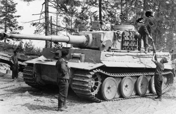

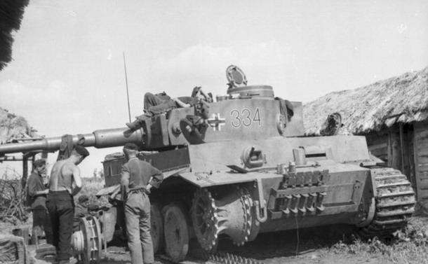

An early-variant Tiger being rearmed, source: Bundesarchiv_Bild_101I-461-0213-34, Wikimedia, Creative commons, edited.
In practice, this amounted to removing the two outer layers of wheel discs, as illustrated in the diagram below — the hatched wheels were eliminated. The same weight now had to be supported by 36 wheels instead of 48, which would not have been possible without a further innovation. Along with the new arrangement, the Tiger received new all-steel road wheels. The impetus for developing the new wheel design was not only the need for greater load-bearing capacity but also the desire to conserve scarce raw materials — the original road wheels had been fitted with rubber tyres around their circumference, and rubber was becoming an increasingly scarce commodity for Germany in the second half of the war.
The designers thus killed two birds with one stone: they reduced rubber consumption while simultaneously simplifying the tank's running gear. The new arrangement reduced the number of gaps between wheels and thus the likelihood of stones jamming or mud freezing in them. This change was applied from the 826th tank produced onwards.
The removal of the two outer rows of wheels narrowed the overall running gear assembly. While in the earlier design the road wheels had extended to the outer edge of the tracks, the new arrangement left a large portion of the track overhanging to the side.

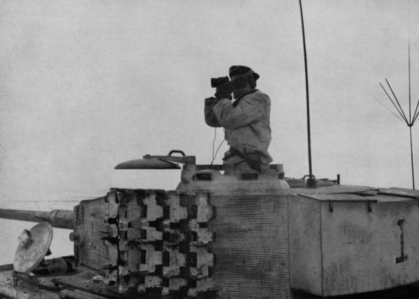

From July 1943, Tigers began to receive a new commander's cupola. The old cupola with glazed vision slits was replaced by one fitted with seven observation periscopes arranged symmetrically around its circumference, giving the tank commander a vastly improved field of view.

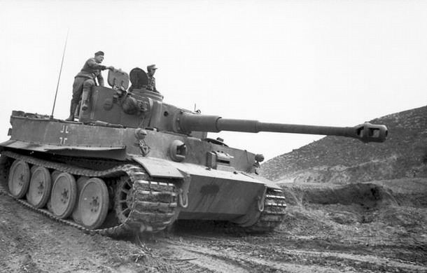

Tiger tank in Africa, source: Bundesarchiv_Bild_101I-554-0872-35, Wikimedia, Creative commons, edited
Around the rim of the new cupola, a rotating ring mount was added for an MG34 machine gun, serving as a means of improvised anti-aircraft defence. When outside areas with a threat of air attack, the machine gun was removed and stowed inside the turret. The hatch opening mechanism was also changed — the original hatch, which opened upward on a hinge, was replaced by one that could be partially raised and then swung to the side.

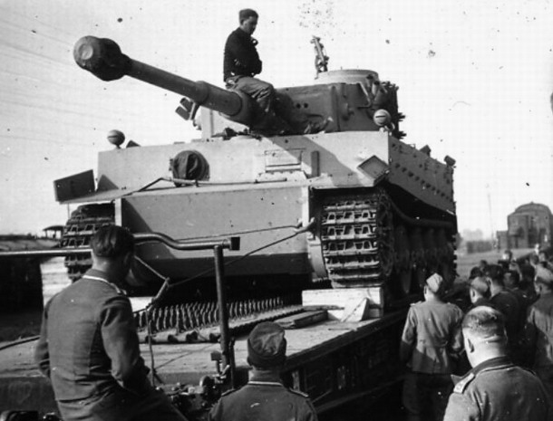

Tiger on a railway flatcar fitted with narrow transport tracks. Note the operational tracks stowed beneath the tank. Source: Flickr.com, courtesy of the publishing user, edited.
The narrow tracks were officially intended solely for rail transport and were not to be used for any other purpose. When fitted, ground pressure increased by 40%, and prolonged use risked damage to both the ground surface and the tracks themselves. Despite this, as countless photographs demonstrate, the narrower tracks were sometimes used for ordinary driving.

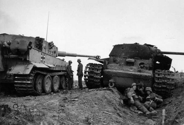

A Tiger and its victim — a Soviet KV-1S, source: Flickr.com, courtesy of the publishing user, edited.

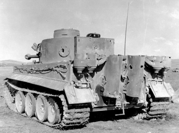

early-variant Tiger captured by the Allies in Africa, source: Flickr.com, Public domain, edited.

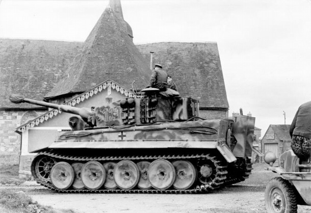

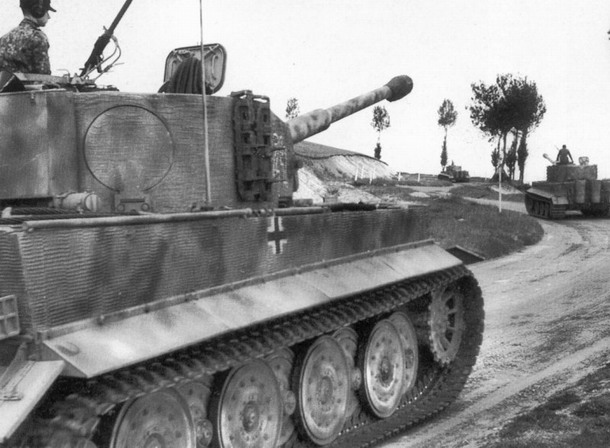

a mid-production Tiger — the vehicle already has the new commander's cupola, but still carries the original rubber-tyred road wheels, source: Bundesarchiv_Bild_101I-299-1804-04, Wikimedia, Creative commons, edited.

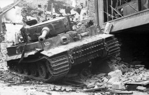

late-variant Tiger (with all-steel road wheels and monocular gunner's sight) destroyed at Villers-Bocage, source: Flickr.com, courtesy of the publishing user, edited.
late-variant Tiger with all-steel road wheels, source: Flickr.com, courtesy of the publishing user, edited.
Allied troops testing the fording capabilities of a captured Tiger, source: Flickr.com, Public domain, edited.
The Tiger's primary control was the unconventional steering wheel; the classic brake levers were present only as a backup in the event of its failure. Source: Flickr.com, courtesy of the publishing user, edited.
the Bergetiger recovery and maintenance vehicle, source: Flickr.com, courtesy of the publishing user, edited.
The Porsche chassis that had remained in the factory halls after losing the competitive trials also found a use. In addition to the Ferdinand tank destroyers built on them, five recovery vehicles designated Bergetiger (P) were also produced (this vehicle is described on the page dedicated to the already-mentioned Ferdinand tank destroyer).
